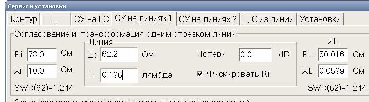

      I'm going to build VFin "option 2" antenna (post #7) using 75 ohm cable for impedance matching.
      I need Real Impedance (Ri) and Imaginary impedance (Xi) of the antenna to calculate the exact cable length for series-section transformer.
      VFin has posted an example in post #36 where Ri=101,93 and Zi=23.43 but are these real (effective) values or is it just an example ?
      I ask this because simulation pictures (post #7) show Ri=59,58 and Zi=2.899.
      I'm confused !
      Please, someone can help ?
      Many thanks.
        Use of geometry in post 161. Re=75 OHm.
          Ok Uve,
          so according to your FEKO simulation in post #165, the series-section transformer should be like this:
          Correct ?
            My solution
              So you are using a quarter-wave transformer.
              Nice solution, though you have to find the perfect diameters of wire and shield to build the coaxial line.
              Many thanks Uve, and greetings from Italy !
