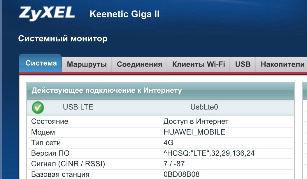

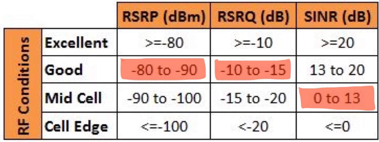

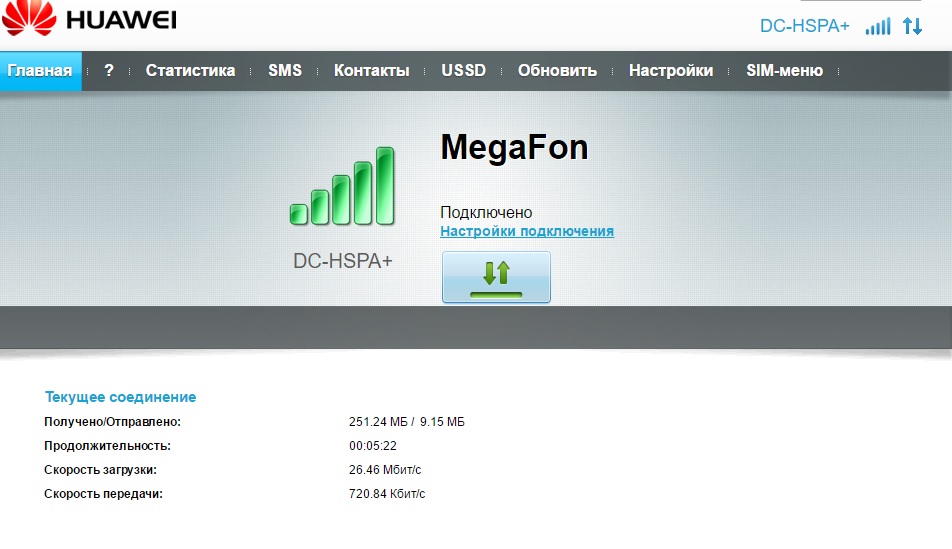

RSSI - (32 -121) = -89dBm
RSCP - (29 -141)= -112dBm
SINR - ((136-1)/5 - 20) = -7dB
RSCQ - (18/2 - 24) = -15dB
